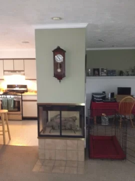

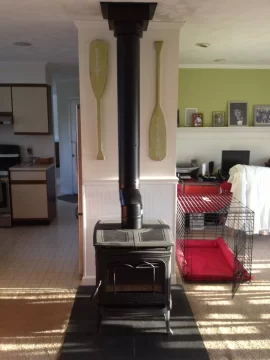

I finally got the old propane fireplace out and the new Alderlea T5 installed. (Pics below) I have been collecting, splitting and stacking since I found you all this past winter. Can't wait for the first break in fires! (And begin the kitchen redo and hardwood floors this winter.) :)
Thank you all again for all the advice and wisdom. See ya by the hearth soon!

What a difference! That oughta warm the place up. Very nice. Rick
Reactions: ScotO
Excellent. That finished out very nicely. You're really going to enjoy the added warmth and lower bills.
Wow! What a classy looking install right there! I gotta say that looks ten times better than that original gas fireplace...and it's gonna put out ten times the heat too! I can almost visualize the stockpot of chili warming on that stove on a cold, snowy day!
I'm betting you feel like a kid waiting for Christmas (waiting for the cold weather to get here)! I know how you feel, I've felt that way since I had to shut my stoves down in the spring!!;)
Well done!

Thank you begreen and fossil! I just had a new heat pump and propane furnace installed and hope they NEVER kick on! Filled up my 500gal tank and want it to last 2-3 years...instead of 2-3 tanks per year. :)

You have NO IDEA! Wait..you HAVE THE EXACT IDEA!! Hahaha I have the AC down to 72 JUST to get us feeling cold. I am READY for an arctic blast. I am looking at some appropriate homebrew recipes for the new kegerator to compliment that chili!
