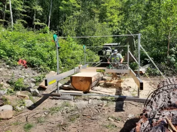

Starting to whittle it down. This was the "small one" about 38" across, the big one (46") is in foreground to the right. We did hit an ants nest in the big one but still got two 2" thick clear slabs 38" to 42" wide before we hit the nest. The majority of the wood was cut into 8" slabs and will be brought to a portable sawmill and flipped up vertically to be sawn into lots of boards.

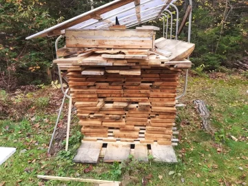

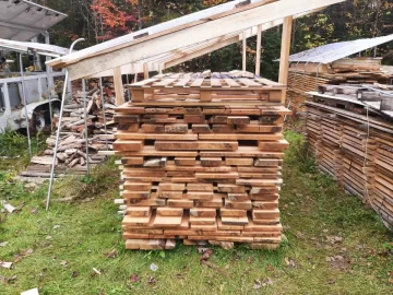

Well the two biggest logs are now a pile of boards. One pile is about 7/8th pine with some poplar and other odd wood on top to weigh it down, the other with the pallets on top is all pine. Not included are two large slabs about 46" wide and 2" thick. My friend did persuade me to cut a few big boards in the second stack. The slanted top covers are to keep the rain and snow off, Its just lightweight corrugated PVC but I have raked a couple of feet of snow. The pine is 10' 6" long
I still have two 38" diameter half rounds and 30" diameter log but we are taking a break. They are higher up in the tree and therefore will have more knots. Probably 95% of the boards are clear with tight grain and knots but there was some ant damaged wood that was worth stacking. There is also a lot of junk logs that are going to rot in place.

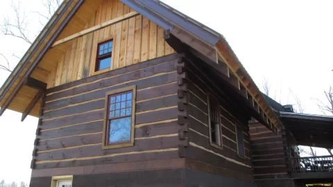

White pine is great for log cabins as long as the bark is stripped. There is a critter called the White Pine Sawyer that moves in quick once a pine is on the ground in non freezing weather. Within a couple of days of the pine being on the ground they were hanging around. They lay their eggs in the bark of pines and then after the eggs hatch, the grubs start tunneling through the bark into the sap wood. On a quiet day a person can hear them munching on a log. The tunnels are about 1/8 to 1/4" of inch in diameter and let in moisture and bacteria that starts the rotting process. I think they slow down once they hit the hearth wood where the sap flow was not active in the tree. They do not appear to bother live pines, I think the pines have evolved a way of keeping them out but once the tree is cut they move right in. Bears like the grubs and will tear the bark off dead pines to get to them. They are about 1/4" round and 1/2 to 3/4" long and bears and birds love them. I ended up with the slabs after cutting the two upper logs and found all sorts of the grubs had come to the surface after a cold night.
