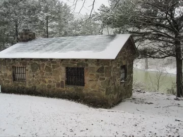

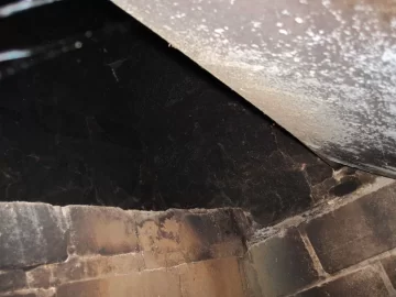

Hello from Arkansas. I have done a lot of reading and searching prior to posting, so forgive me if I overlooked my answer.
My dad and I own a small 294 sq foot cabin in North/Central Arkansas. It was built in the early 50's and designed with an open fireplace. Years ago we installed a heavy duty stove along with SS stove pipe to keep from buring through so much wood and to get more heat out into the cabin. The stove worked great for years, but for whatever reason, five or six years ago, we decided to take out the stove and sell it.
Now, years later, we have realized that in order to stay warm we have to burn through a TON of firewood! My quesiton is:
-What is the easiest way to produce heat w/o putting in a full stove?
-Is an insert the answer to our problem?
-Can a "front" of glass doors only be installed to better control airflow?
-Can we seal off the chimney opening with SS pipe to downsize to the proper ratio and get better draft while producing more heat? I assume that wouldn't slow the wood burning down at all...but just a thought.
Ideally we would like to have large doors that would open wide or remove entirely to have the option of an opend-fireplace-feel.
Inside the chimney is a HUGE open void, way to large for proper draw. As the fire cools, we get smoked out from time to time, although my crude sheetmetal air guide helped quite a bit.
Thanks for any help. I'll admit I like the open fireplace, but hate burning through a rick of firewood per weekend, and I am leaning away from installing another large heavy stove. \
Dimensions are as follows:
Front Across 37"
Rear across 31"
Height 31"
Depth 21" at top
Opening into chimney appx 31" x 9"

That place looks awesome.
You should be able to slide a stove into that fireplace and drop a liner down the chimney. An insert would be a problem with no electricity, but some are more convective than others and may do a decent job of heating the space on its own. I assume there is little to no insulation? I'm not sure I would want to go to sleep with a poorly drafting fireplace.
There may be some other options, but I would say you're going to have to give up the open fire, or give up some floor space and put a stove back in. Or just keep chucking wood in the fireplace.

Indeed, that's a beautiful little stone cabin.
Glass doors would help, but the fireplace will still be a heat sucker, drawing a lot of warmed air out of the room as the fire dies down. No, you should not change the chimney interior for the open fireplace. The reason it's spills smoke is partially because of design and the short chimney. I imagine it is particularly balky during damp 40-50º weather until the chimney gets warmed up.
You had the right idea with the old stove and stainless liner. That's going to do the best job of heating the place. Those stone walls will suck up heat like a sponge when it's cold outside. With the short chimney I don't think a modern EPA stove would work well. Instead I would look for a stove that can have the doors open if you want an open fire, yet closed for heat. An old Fisher, Timberline or Vermont Castings Resolute would work.

beautiful place...looks like you have running water....get a bucket, run outside to the creek and run back in......I'd op for a small stove if i could get one. something small enough to fit inside but possibly cook on too. thats just me. i had a small jotul that fit the bill for me 20 years ago. it saved our bacon more than once when the power went out during winter storms. have since moved but was able to bring the stove with me and i still have it.....but don't use it right now. might put it in the garage. can't seem to be able to part with it.
cass
If the Buck's interior is in decent condition and it hasn't been abused, then it may work. A wire brush and some Stove Brite paint can work small miracles in the looks dept.
The way that thing is built it looks like the old county jail. LOL Were the bars a later addition to prevent vandalism?

To answer the question about the bars on the windows, yes, they are to keep people out. Years and years ago it was nothing but wooden shutters latched on the inside. After the place was willed to my dad and people broke in a couple times, he had the bars custom made to fit the window frames. We have since added storm windows with screens, also had to be custom made. After the deadbolt was bashed in, we added the steel reinforcement on the steel door and have not had any problems since. It's very remote, so people that want in have time to figure out how. Sucks that people want to go to that much trouble to break in to steal a skillet and lantern, totaly not worth it.
