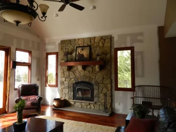

Madison, the planned hearth height is 12 inches high. The wood 2x12 shown in the pic with "hearth" written on it is the profile of how high the hearth is. I've included a few pics below of the same image colored in (using MS paint software) so you can visualize what it would look like as is. I'm trying to decide if the fireplace "hovering" above the hearth looks ok or if I should go through the trouble of lowering it.

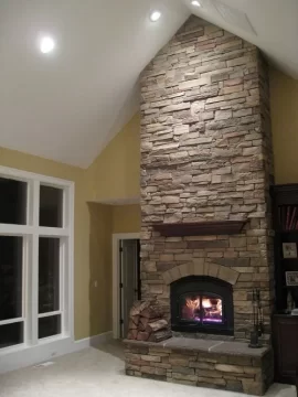

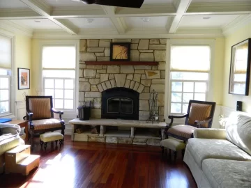

I put two Quad 7100's in my house this past fall and both are raised. I think they look great that way, nice to look into the fire as opposed to down at it and easier to clean for sure. Also, looks like you have a cathedral ceiling like I have in my family room. I highly recommend adding a ceiling fan if you don't already have one.

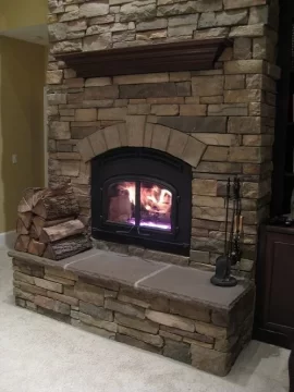

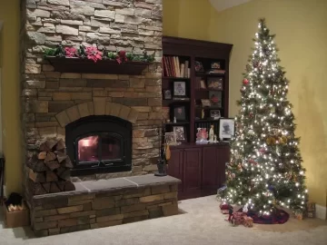

I went thru this process a few years ago when we built our home. After reading several threads in the forum re: the pros of a raised hearth [e.g. easier to load/no bending, fire at eye-level, a place to sit...] we ended decided to go w/a raised hearth at 20". My wife and guests really enjoying being able to sit near the fire, well they can't sit by it too long when it really is going...;)
Here are a few pics.

JJL those are simply incredible installs. Looks like a Pottery Barn mag...Awesome work!

Wow, thank you for the responses and especially the awesome pictures! After seeing what you guys have going on, I'm thinking I'll keep it at the height it's at. I really do like the increased accessibility to the firebox for cleaning and loading. I also tried sitting on various surfaces at various heights, and a 1 ft hearth seems too short. Something more like 15-20 inches seems much more comfortable. At that hearth height, the "hovering" effect goes away. And even then, the hover look isn't bad at all, I've seen it several times now and as long as the stone/brick work is done thoughtfully, it looks fine too. It actually reminds me of a stone or brick oven and doesn't look unnatural at all.
Blue2daries I had seen your pics before and I actually tried to find them but couldn't earlier. THANK YOU for posting them, your fireplace looks fantastic, a truly well executed install. Makes me very comfortable in keeping mine right where it is. JJL1 thanks for your pics too! I really like the raised hearth with the compartments under it. Never seen one like that, but it makes sense to utilize all that volumetric space under the hearth. I might borrow that idea for my own.

Woodrow,
I am glad to liked the pics. You are correct that there is no molding on either hearth. In the living room, there is a 6 inch high wood frame for the bottom of the hearth compartment that the stones are attached too. They sit about an 1/8" of the ground so they look real clean up close. The big slabs of stone on the ends that are used for supports for the hearthstone also have cement underneath them as well as behind. My preference would have been to have the wood storage compartment go all the way to the floor, but when I ripped the old hearth out, I discovered the builder snuck exhaust pipes for the hot water heater and furnaces in there. In the family room, I had the brownstone hearth bull-nosed and I had planned to place it directly on the wood floor and place a small quarter round around the edges. However, the 1" of Micore, a not so flat subfloor, and the cement underneath the stone placed the hearth about an inch off the wood floor. I was able to find a reddish thin set to fill the gap and when combined with the bull-nose, it gives the hearth a floating effect.
As for hearth height, the living room hearth is 18" from the floor and 20" deep. I am 5' 8" and it is perfect for me. I would think anyone under 6' would find it comfortable. I am going through the planning process for a new patio with a sitting wall around the perimeter and 18" - 20" seems to be the favored height for sitting walls too. The hearth stone is 90" long which makes for quite a few extra seats when the bucket and tools are placed on the floor. The center compartment heats up to the mid-90's when I have a good fire going, so it is a good place to store wood to be burned the next day. The end compartments don't heat up beyond the room temp.
The biggest potential issue I found with the raised hearth is the mantle height. I am not sure about your unit's requirements, but the Quad requires 60" from base of fireplace to bottom of hearth. That was a bit tight in the living room and I debated about putting a mantle in that room at all. In the end I am glad that I did. I also wired both for electrical, cable and ethernet (behind the pictures). I would not even think of putting a tv up there, but in case I ever sell the house people will be looking for it.
I have found the ceiling fans to be a must have. I bought DC powered fans that are virtually silent and they use less than 18 watts on high speed. In the family room with the fan off the heat will rise to the top of the cathedral ceiling and stay there. When I turn the fan on, the temp on the furnace control will increase by 3 degrees within minutes. It also helps in moving the heat out of the room and up the stairs into the bedrooms.
