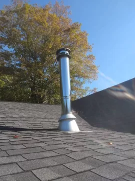

So I got that pipe last night, and I have a chimney where there used to be a pellet stove in my house, can I use this stuff for the chimney that extends past the roof? It's the same size I don't know if I should close up that opening as it won't be used anymore
What is this a picture of - The existing chimney that the pellet stove was connected to or the used chimney pipe you just purchased?
This is the existing chimney, above my living room, previously used for the pellet stove, it's the same stuff as the stuff I bought yesterday, 6" class A

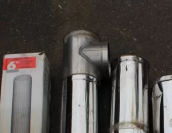

Ok, so it looks like I do have enough class A pipe, I the attic will need about 6ft, the second floor will need 8ft, and then a long enough section to get past the floor and close to the boiler,
Now I have this tee, this is superpro brand stuff, do I need a cap for the bottom? And some kind of adapter so I can connect the regular pipe coming off the boiler?

Are you sure the existing pipe on the roof is Supervent? The cap doesn't look like Supervent.
What is the plan for terminating the chase? Will this be on the 1st floor? If so, what is supporting the chimney pipe? Will there be a ceiling support in the basement ceiling for each pipe? If so the tee is not necessary.
Have you made up a drawing of what is being proposed?

So the pipe I got attaches perfectly to the existing pipe that's going through the roof, so it seems like it'll work fine
