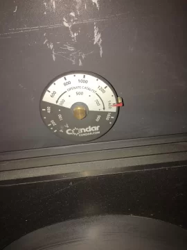

I replaced my original cat meter with one from condar. Here’s a photo. I am very happy with it. Allegedly, condar made the original one too. The condar folks sold mine for my stove but your model is so new that they might have to check for a match.

Thank you Highbeam! I will check them out.
