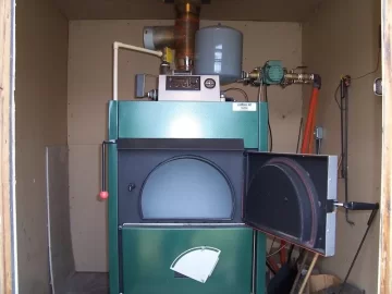

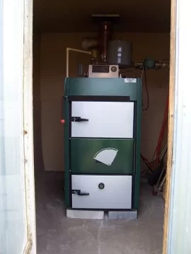

Here are some pics of the Biomass 40 in a 10x12' building. There was a New Yorker WC130 in here before. It's hooked to 2- 50,000 btu coils on 2- 1 1/2 ton heat pumps and also to a superstore 30 gal indirect water heater. I hope the pics came out ok.

Nice looking unit. How many gallons onboard water?? That's about the same size expansion tank I had originally but found it to be too small for my application. The triangular shield on the front is some sort of air control?

It is beautiful when is brand new ! :)
You are sure that the expansion tank are not inverted ?
It holds 40 gallons of water. I had to put the expansion tank on upside down for clearance issues. It won't hurt the operation of it. I have another expansion tank on the oil boiler that it runs through in the basement.
They shouldn't be installed upside down because air can collect in the water side and cause corrosion.
