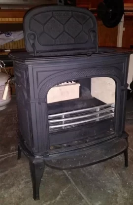

Hey guys. I am looking at an Intrepid this weekend and wanted suggestions on what I should look for condition wise. It has some surface rust but was used last season. New gaskets last year. Photos attached. $175.

Idomenus, the only real deal-breaker with those original Intrepids would be damage to the front and/or doors. The hinge bosses sometimes get snapped off, and there are no replacements available new. But if those hinges ARE good then GRAB THIS STOVE!!! Great little heater, very simple to run and maintain. If you find you DO need something, let me know. I have few old ones around.
