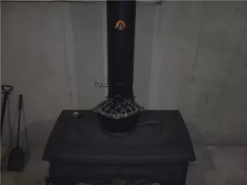

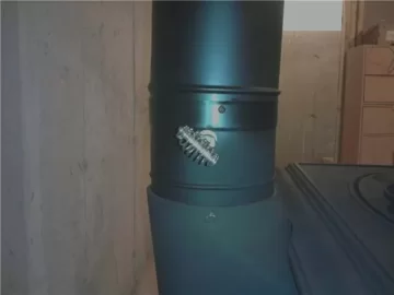

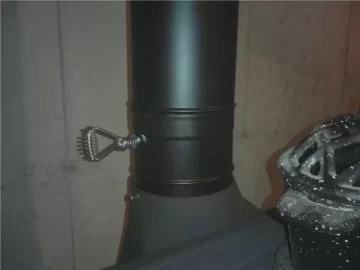

Just finished installing the damper....worst case scenario it dosnt work and I can remove it. I'll have to report back tomorrow as to whether or not it works, outside is a little to mild for a fire tonight.

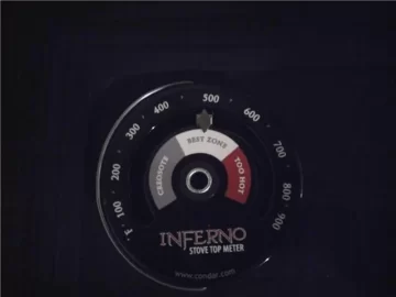

I think both thermometors are accuarate for the most part as I put the inferno on the black pipe just below the probe....i.e. probe reads 800, inferno reads 400.
Perhaps they are both inaccurate, but I really dont think this is it.

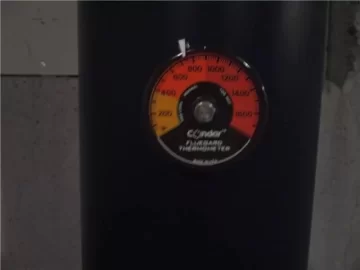

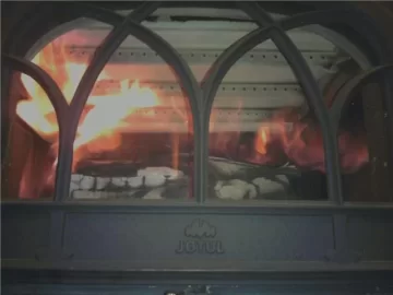

Well the results are in and it seems to be working well. Established a coal bed when I got home, added wood, chard for about 10 min with damper closed about 1/4, adjusted primary air to 3/4 of the way down with firebox at 450, stove top rose to 500 where it has been for a good 60 minutes so far. Flue temps are still a little on the high side but I am now feeling powerful waves of heat rising from the stove top, enough to feel like a lite breeze and am pretty darned satisfied SO far.
