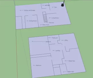

What is your floorplan?
Here's my floor plan
Just some things to think about on this.
- How do you plan to bring wood in to the house? I know that this floor plan is just a quick sketch, but are you dragging wood half way through your house to get to the stove?
- Are you going to be running a fan to help get the heat out of the den or have some type of ceiling/floor vents to help get the heat upstairs?
Id think wood getting to the stove would be the lowest thing on the totem pole. I'd pay attention to heat delivery throughout the house.
