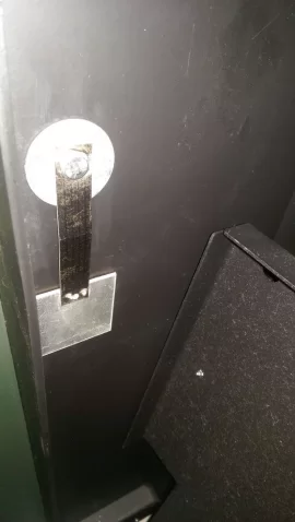

Could you elaborate on that? I started burning in my new ideal steel last night, and the rattling starts around 200.
Mike from WS had me try this.
You can take the cover on the rear right ( as you face stove) off, just a few small bolts to get to the part. It is a metal square attached with another strip of metal. Take that bolt off and add a small thin washer. It will still close and open when needed, but wont rattle. Like the magnet idea also.

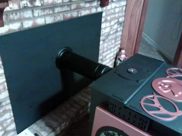

Here is a picture of our install. I was amazed at how well this stove draws being a back exit install like this.

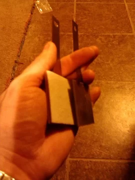

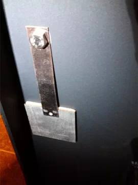

So here is the mod woodstock has come up with to silence my catalytic alarm :)
The old part is on the right (flat SS plate with a bimetallic strip attached to it). The new part is on the left, same thing but with a very heavy gasket on it.
[Hearth.com] Our ideal steel in charcoal and copper
This is the new part installed (guess what was in the mailbox when I got home today)

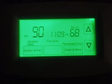

Here is a picture of the thermostat in the stove room from Saturday at 11pm. I decided to see how well it heated and got the stove up to 625 surface temp (on the plate that covers the top flue exit, since we rear vent). So running hard from 8:30 - 11, this is what you get......
Now that is in the room with the stove, but still :ZZZ
