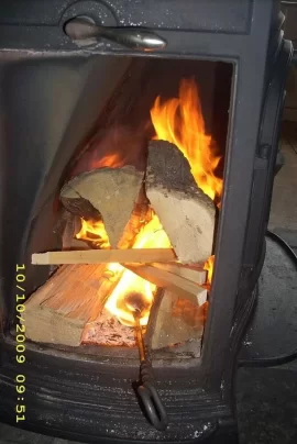

So the wife and I just had our 9th wedding anniversary, and the traditional gift is pottery. So I headed down to the local potter and she had this nifty firestarter. It's a piece of pottery that you fill with lamp oil and has this "wond" with a stone that absorbs the oil. You roll this stone in some ash and light it and place it below your wood. It burns for about 20 minutes. No more newspaper......and with the dry wood I've been using, it gets roaring in just a couple minutes........now even she can get a good fire going!! :) and when she's warm....she's happy!

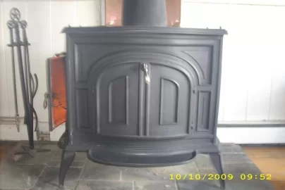

I also noticed this crack on the bottom plate. This is definately new and goes back under the stove for about 3 inches. Are there any concerns or should it be good for another season?

Can't really see the crack, but I don't like it, especialy on the bottom.
Hate to see that crack grow or open up when stove is at full tilt! not on the bottom, droppin hot stuff out, lettin uncontrolled air in! like my house more than my stove! cheaper to replace the stove than the house in my opinion. Just my 2 cents.
I totally agree with pineburner. There are places where cracks can be patched or simply lived with. The bottom of a stove is not one of them. This might be repairable with brazing or welding, but I sure wouldn't just ignore it and hope for the best.
A bottom crack is a rare occurence unless there is a defect in the casting itself, but this would have shown up long ago. With the recommended minimum of 1" of ash to protect the bottom, a crack should not happen. Which makes me wonder about using any liquid for starting fires in a stove. Most manufacturers specifically say not to. Hot flammable liquid dripping down through the protective ash layer could well have caused the crack.
Thanks for the feedback guys...much appreciated. I guess the next question is.....is it worth purchasing a new bottom or just look into buying a new epa stove.
As for the firestarter....I was concerned with the liquid, which is why I was looking for feedback on using it. However, the crack happened during our first burn this year before we started using the liquid. I think it may be more that there was no ash "barrier" on the bottom of the stove....hmmm.
If you don't have ash available, sand in the bottom of the stove will also protect it.
A "good" welder can fix the crack. It should be welded, not brazed.
Huh, I thought you braze cast iron, not weld. Anyhoo... Thats the worst place for a crack as far as safety goes. It's a fairly easy fix provided you can get the rods out without too much drama. You should be able to get a new bottom for a couple hundred bucks and get it fixed in one days worth of swearing and getting dirty. If I remember correctly (I've rebuilt over 50 Defiants back in the 80's) It does require standing the stove on its head. If you decide to give it a try, you can always email as you go along. I may be able to recall enough to help you thru any trouble spots. Or a nice big EPA Certified tax credit getting side load stove...The Jotul Firelight comes to mind.
