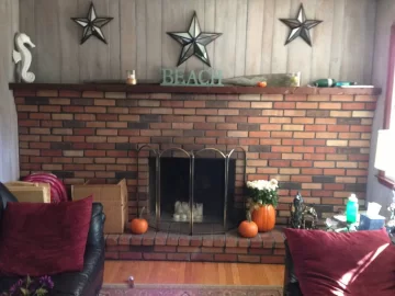

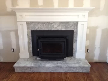

BobUrban- here is a pic of everything as it is now. I'm in the tail end of a renovation and this is my crown jewel. Here's a pic of what it looked like before I started the renovation as well. I like it much better now. Click on the thumbnail and it will enlarge so you can see the whole photo.

Very nice! I like that a lot and I stand corrected on my stone stove prediction. I was just assuming it was a soapy.
Fortunately others are much more savvy than I on here - I didn't even know Hearthstone offered an insert. Never stop learning here on Hearth.
Very Nice Clydesdale build.
I am in the process of installing Clydesdale #2 with a white marble hearth and hearth extension. The fireplace and hearth date back to 1964.
I have a lot to learn, but I'm having fun along the way. By the way, its nice to hear my wife saying that its getting too hot in the house - I've never heard her say that, literally or figuratively lol - last night the house was a steady 75!!
Gotta ask cos a Hearthstone Clyde is on my wish list -- is the white material surrounding the marble wood or some other material? (As I try to figure out what clearances in my fireplace are from exactly which part to what to exactly which other part)
OldLumberKid - the marble surround is actually Super White aka White Fantasy quartzite which came from the same slabs as our kitchen counter tops (I've been told that its harder that granite but with the look of marble - who really knows). The mantle is poplar custom made by a co-worker who does wood working on the side. The whole thing came out exactly as my wife and I imagined. I had to jack hammer and sledge the original hearth and façade (circa 1968ish?). The only thing left now is crown and base molding and paint. I'm so burnt out from this project I've been working on this reno since March 2013!!

OldLumberKid - This wasn't easy to do I must say considering that I never did anything like this before. The firebox and the hearth are off, if you look close in the pic you will see that I had to have the stone fabricator cut me a filler after his install when we decided to with the Clydesdale. If I was home when he measured everything I probably would have caught that and had him add 1 1/4 inches to the sides of the hearth to make everything even. Because of this difference, I almost went with the Fireplace X flush mount shadowbox because it may look better "floating". But this quick filler fix will do and it doesn't look horrible with the Clyde sticking out. I didn't want to break up the hearth just for this. Way too costly. I'm glad I went with this unit.
