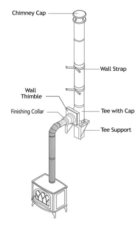

I was doing more research and I worded it wrong, it is the "stove pipe" from the stove to the chimney, That I had questions about,
I have the install manual I downloaded and all it says is a class A chimney, which the DuraTech is. [Hearth.com] out the wall install questions.
I have the install manual I downloaded and all it says is a class A chimney, which the DuraTech is. View attachment 167888
That is a diagram for a stove installation. The Gemini is a fireplace by the description. It's an odd bird in that the manual allows it also to be installed freestanding fireplace with the add-on base. Regardless both installations have chimney pipe, not stove pipe coming out from the top of the unit. There are no 90 deg elbows for class A chimney pipe. The chimney pipe must go straight up with only 15 or 30 deg. offsets allowed. If you want a stove installation you should be looking at the 32XLB not the Gemini or an equivalent stove.
I talked more in depth to a guy at work that bought the same fireplace, and we called the dealer he used, you are correct you can not use stove pipe on this unit,the chimney has to be a direct hook, which means I can not do an out the wall install, and must go through the roof... which I'll have to hire someone to install.. steers away from my cost savings but at least it will be done right, and safe.
