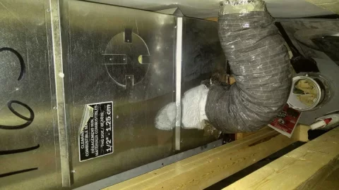

Anyone have any suggestions on how to cure this issue? It's on a focus 320. The outside air kid is insulated but the side of the fireplace still ices up with cold weather. Any suggestions?

What exactly are we seeing? Is the sheet metal where the duct passes outside? You say it is the side of the fireplace but it seems that the heat from the fire would be melting the ice where the metal is.
Sorry here's a better picture. Yes it's the side of a zero clearance rsf focus 320 fireplace. The outer sheet metal of this fireplace stays very cool while there is a fire, as you can tell from the ice on the side even when there's a fire. In fact I think having a fire makes it worse as it then draws more air through the outside air kit.
Does anyone else have this issue or does the outside air ducting in most zero clearance fireplaces stay hot enough to keep ice off? Keep in mind I'm in rural Manitoba, this week has been highs of -20c (-4f) and lows of - 33c (-27f)

So all of the issue is on the outside of the fireplace sheet metal? Insulation should do the trick. Anyone have a reason why he can not insulate the side of the housing here?
Well the only reason I haven't is that sticker on the side that says "1/2 clearance to combustibles" . The best insulation would be sytofoam or spray foam for this area, both combustible.
With fiberglass I would imagine I'd need to vapor barrier it too so the insulation doesn't just get soaked.

Roxul bat insulation and a vapor barrier would be best. If it is well insulated (you need more than you have on that air inlet with how cold it gets) you will not have condensation build up. That air inlet is poorly insulated, would you tolerate about an inch of insulation in your house wall? You effectively have a wall there. Once the cold air gets into the fire the coldness is not a big issue. But outside the fireplace it is cooling the (closet?) area as air is moving in.
