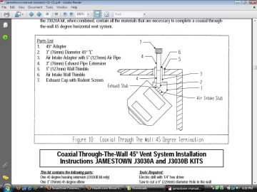

Nice story, For me I say RUN THE OAK.....I did and will NEVER switch back....my kit didnt require a second hole...I have the fresh air intake around the 3" exhaust,that is the kit made for mine....1 pipe exits the house,intake stops 6" or so outside the house as the 3" continues horizontal for 1 ' and then goes vertical.
Awesome.....So to all run it...it will benefit every stove.Its logic people.

That is the vent setup that I wished I had gone with. I didn't know about it when I bought mine. I have heard others speak of condensation on the OAK. It would seem to me that with your setup (like the Selkirk- Direct-Temp) the intake air may get pre-heated as it is drawn in around the 3" exhaust. Is my assumption true? Do you see any condensation with your type of OAK?
luv my direct temp
no condensation either
vertical install
No Not at all its a short run.view my pic
