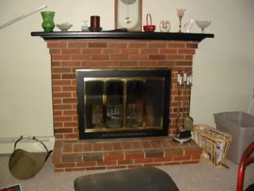

Has anybody used the -- Condar ASV-90 air supply Ventilator? I was thinking about putting one on each side of are fireplace so it will draw its air from there instead of the reast of the house. Do you think it will work??

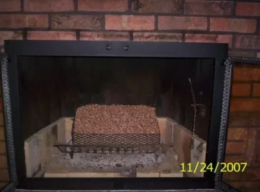

Under those firebricks is the steel plate that covers up the ash dump. The air come up through the ash dump then forward to right in front of the doors where there is about a 1/2" gap to let the air escape up into the fire.
