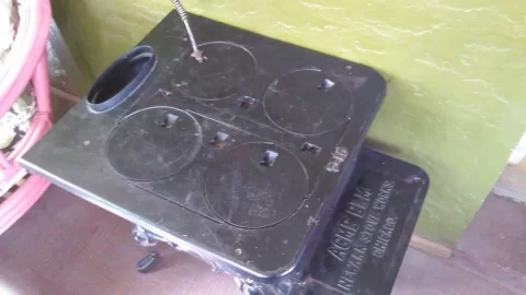

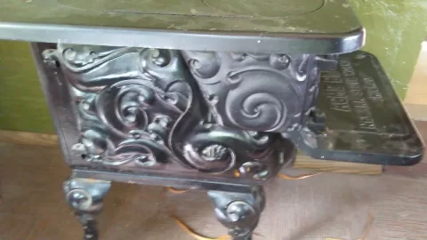

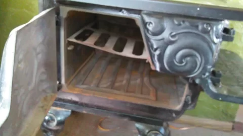

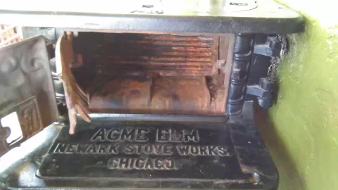

Thanks everyone. I think I can get this done. Wish I could find information about this stove. I can find information and pictures on the Acme Triumph, Acme Oak, Acme Ivy, Acme Jewel, Acme Oaknut but not one single word, mention or picture of the Acme Elm. If I didn't have one sitting in my house, I would debate its very existence. Here's a pic of my old girl.

Small stove, it may be a laundry stove or one made for work crew cabins. Maybe check to see if your library has a turn of the century Sears catalog that might list it?
I thought laundry stove at first too but laundry stoves don't have ovens and this one does. I had heard that Sears bought the Newark Stove Works sometime around 1905. I don't know if stoves made at Newark still had Newark stamped on them after Sears bought them or not.
Have you contacted any of the antique stove restorers? They may have an old catalog listing this one. Their contact info is online.
