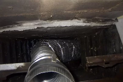

It took me and a helper about 6 hours just to get it insulated and pushed down the chimney. Not sure if that's average or not? The first 15-20' is a straight shot and that went pretty fast it was the last bend and into the smoke shelf that was the PITA. My helper curled up in the fireplace with some 1x3's of various lengths and an assortment of hooks and bent over nails to coax the liner down. It took a long time at and inch per pull but we got it. I cut a plywood oval and screwed it to the liner with an eye hook and that helped until the bend got to severe for the rope to do any good. The oval came down with the long dimension wanting to go through the narrow 5.5" damper and the oval liner is not very flexible so you can't twist it 90 degrees to fit through. I ended up cutting the back of damper and it just slid through.
The next day we pushed the stove in only to find it wouldn't connect to the liner-couldn't push it far enough back, stove was hitting the firebricks in back(bricks arched forward as they went up). Had an adjustable elbow on hand but it's height was so darn tall I'd have to cut the liner real high and making a good tight connection to the liner seemed questionable. So we called it quits and I just let the options gell in my head for a while.

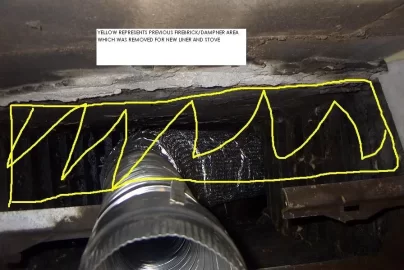

I finally just decided to start pulling out firebricks under the cut damper. They came out quit easy-the mortar was shot. The are very thick compared to the bricks in the stove. I was able to gain a few more inches of room. Behind the firebricks is an 8" thick block wall. I now have more than enough room to hook the stove up. The crummy part is that the stove will sit completely inside the old fireplace, so I don't know how much heat I will get out of it? I haven't put the stove back in yet because I'm filling the side walls of firebricks back in with the ones I took out of the back. It looked ugly and unfinished to leave the sides with a 4" gap in the back on each side. I've got one side left to mortar and then the stove can go back and the roof cap can go on. Had I know the bricks would need to come out it would of made a lot more room for coaxing that liner down. My helper is skinny and might of been able to stand up in their now. I also will finish cutting the damper back to each side when I'm done with the firebricks.
