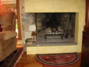

Thanks for the insights! I'm definately committed to cutting out the damper piece since the cutting has begun! I will be running extra rigid pipe above chimney along with insulation. I don't want to be outside in the winter trying to make improvements. Hope to post a picture once the job is complete. Thanks again for sound advice.

One suggestion, look for a ridgid piece compatible with your system that is double wall pre-insulated. I think it will looks nicer than trying to use single wall and just wrapping insulation around it. Maybe Hog has some pics?
Twelve feet might work for you IF you are using rigid liner w/ few or no bends - some folks do rigid in the chimney with 4-5' of flex at the end to make the connection to the insert, which should also work fine. It will also help to have an inside chimney, and to insulate the liner. This will give an optimal setup aside from the height, and may make up for the "works everywhere" 15' generic listing. However your code official might insist on the 15' minimum - some do, some don't... In either case it won't hurt to have the extra, as long as you insulate the extension as mentioned earlier.
Also looking at your picture, you might need to think about extending your hearth - remember that current requirements are for 18" in front of loading doors, doesn't look to me like you'd have anything near that, and the hearth rug does NOT meet the requirement. It would be possible to extend by taking up an area of the wood flooring, and possibly part of the subfloor, then building back up with non-combustibles to the required minimum R-value and covering with stone or tile to have something flush with the floor.
