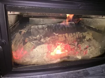

First photo shows the secondaries taken @ 12:21

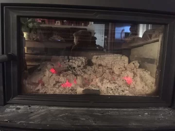

Second photo shows coaling taken @ 3:32 not putting out much heat

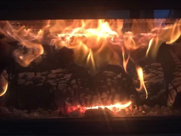

Third photo is what happens when I knock down 2nd photo. They are beginning to glow but as soon as I close the door they start going black again. Soapstone pieces are pretty clean in photo 2 but go black in photo 3.
Is this how it's suppose to be?

Quick check for the moisture meter is to lay the pins on the palm of your hand. It should read somewhere around 32-35%. All of those pictures look relatively normal to me. But even with the primary control completely closed on my NC-30 the coals right in front of the "doghouse" air inlet thing are glowing white. If you open the primary all the way when its running like the 3rd photo shows do those coals burn hotter?
That is open all the way. Do you get much heat when it is at this stage?

No, the 30 makes the most heat when the secondaries are lit. Once everything turns to coals it will coast for a while in the 200-300*F range but it will burn a trench through the coals from front to back and start working towards the sides.
