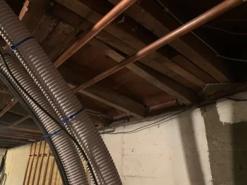

We got a second quote from the only other game in town and they said we can't put an insert in our fireplace because it looks like the wood form and floor joists are under our hearth.
Now, to me, it looks like the form is only there under the hearth extension. However, I haven't seen in any manual where it says you can't have wood(or a combustible material) under your hearth slab (Directly under where the wood insert sits).
Is this true? Do I need a high R value directly under the wood insert as well?

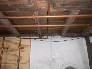

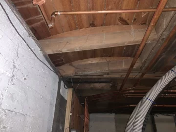

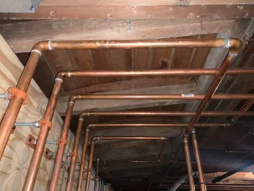

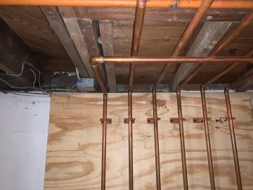

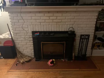

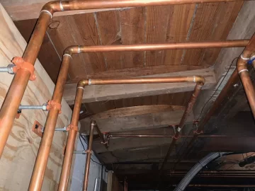

Pasting photos below. Pardon the severed dog toys on the hearth extension. My dog is a monster.
Under that I will put a youtube link to a video I recorded of the basement and the form. That may be a clearer video.

Just cut the wood out
How far in front of the insert door does the hearth extend?

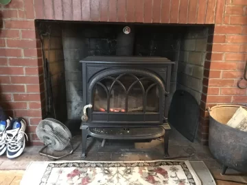

If you do put in a freestanding stove a small fan just on the floor works great at blowing out the hot air. Raises house temps in my house by a number of degrees. Also with this stove the bricks under the stove barely get warm. Even without a fan and burning 24/7.
