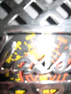

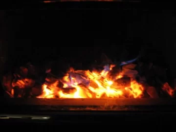

13.5 hr old fire, stovetop is 325

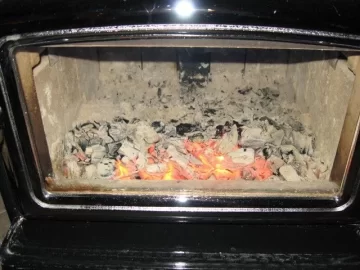

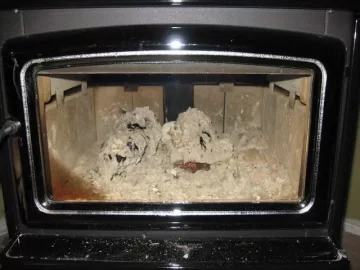

15.5 hrs old...coals to spare. Cleaned the glass and raked everything forward.
That is with my wimpy little stove. I think Northof60 would win unless somebody signs up with a King model. If Northern Virgina ever get a real cold snap and BB can let the reins out on the 30 he could be in the running too. :-)

Thats impressive Gunner. I think that hard wood makes the diff. We are pretty comparable, thats my results @16-18hrs on low,low @22hrs I can still relight with coals stove @ 200 using two 8"rounds one 6" & filler peices but I think your heat output over the durration is going to be better. I really need to try that hard wood. Any doners? :)
P.S. these would be the fall and spring settings for heating the house or used when we are gone for overnight. To heat the house now down to-30C a 10-12hr burn is what I get to keep the furnace off. Any colder as low as a 6 to 8hrs. Lots of those lately. :sick:
