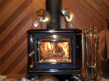

I have owned 3 wood stoves in the last 35 years , presently still own a 1999 PE Spectrum Classic with gold plated door, legs and trivet clad in lustrous black porcelain enamel, this model is now called the Super Classic LE now-a-days, a really great stove that still looks as good as the day the dealer delivered and installed it in April 1999, so needed to look good and feel comfortable in the room, not out of place. The look of the stove was extremely important to us because it is in the room we all spend the most time in ( 15ft x 24 ft family room ) . Except for door gaskets that I change myself every 3 years or so ( I am a stickler on that ) and the floating side rails that I changed after 21 years of use, it is all original. If I were to purchase another stove tomorrow it would probably be the same stove clad in cast iron a Alderlea T5 or T6 ( IMHO the best of both worlds ) PE's once piece baffle and floating fire box to me is unmatched in the industry, the simplest, easiest and quickest stoves to maintain, clean out and put back together. Like many friends and family had to do in the past no $300.00 - $400.00 catalytic converter to replace at between 3 - 5 years of use, ( curiously these cats for various reasons never qualify for warranty or so it seems according to them) . I might however consider Jotul cast stoves, Morso or a soap stone stove but these are so pricey it would take me a while before warming up to it's pricing.
The only thing I do not like about my stove, is the built-in ash dump and ash tray, although they do work to me they are both more trouble than what they are worth, I would suggest PE eliminate these as standard and strictly offer them as options only to customers who might want them.
