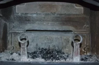

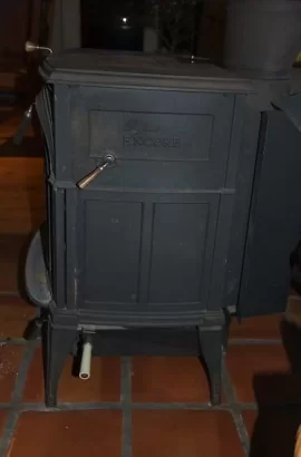

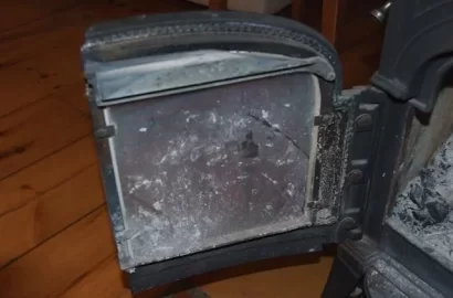

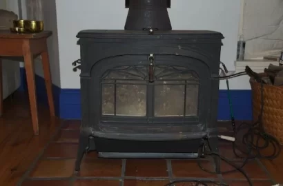

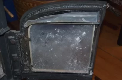

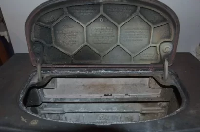

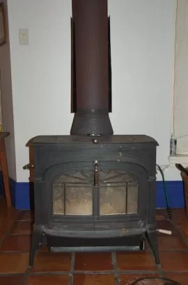

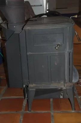

I did the light test (without shop vac'ing the stove, unfortunately) and it was all dark, except for the front. :-)
Here are the first 4 pictures...

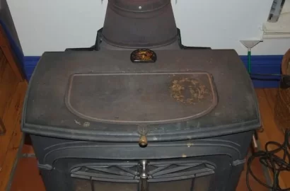

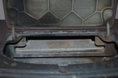

and the rest. Do these show enough to make an assessment?
Martin

Stove doesn't look all that bad Martin. The heat shielding and clearances to combustibles do look a bit suspect though. Glass needs cleaning too :).
What do you mean by the stove is operating "finicky"?
Well the flash makes it look worse than it actually is. :-)
when it was installed it was all up to code: 24" to rear of stove, 20" in front; side clearances are 10". I know that I need to fix the 8" pipe since at 12" the heat shield should go all the way to the ceiling. I plan to fix that (or go to double wall pipe?).
So how is it misbehaving? On startup, on cat mode? dampering down?
Basically, I'm not able to close the damper without stinking up the house.
What is the difference between "cat mode" and "dampering down"?
When was the last time the flue was totally cleaned out ? That would be step one. I'll wait for Elk to log in tomorrow, but it sounds like rebuilding the refactory assembly and getting a new cat (with lower combustion temps) may be worth a try. I would do it now. It won't take as long as you think and the season is still young.

The ash still in the stove will block off the seams where it could be leaking the first set of pictures third one in from the left a side view the rust around the seam line may indicate refractory joint needs to be cualked If you can get that cleaned up Vac out then do a light test one acn also use a strong bright flash light and aim it at all the seams including the top griddle gasket. It is possible to recaulk joints without fully dissesembly. I agree that stove is a prime canidate for rebuilding,
with the refactory package gone secondary burning and dampering is useless. chances are the secondary air passages are blocked and that explains why
the smoke backs up.
If you were able to disconnets it roll it out into a garage and use a blow gun and compressed air s with a shop vac you could really examine the joints I also use a small wire brush to get the stuborn ash out od the seams and then shop vac it again. When blowing it out wear a dust protection for breathing and do it outside in the process it will expose leaking joints.
To reaslly get at the entire interior of the stove one shoulf remove the top Usually held on by 4 connecting rods bolted to the bottom this will make it eask to work on the damper assembly
and access to caulk all seams from inside. When done with the refoctory package, damper working new gasket on the damper plate and new cat combustor this stove will operate as new
you will re-discoved how it is susposed to opperate
