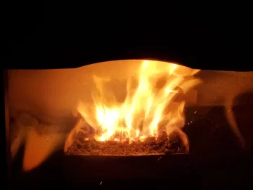

Hi, I'm back with the same issue from 2017. I have two P43's from Aug and Sept 2011. Currently, feed rate, stove or room on maxed and temp on max. I can't seem to get the burn pot full enough to create a good flame. I have the OAK and exhaust goes straight out 3' or 4' 3" pipe. Also, after cleaning and when on higher heat setting, i get the dreaded rumble/woofing.
I read through my previous post and others and could not find out if they ever resolved the burn pot design issue? The stove will heat up and maintain, but is slow to get there. Stove burned much hooter when new and feed rate on 3 to 4 would push pellets over the burn pot ledge. Now the flame looks like its just trying to maintain.

Feed rate maxed stove temp makes and Hammers for pellets. Recent full clean. 20211129_084501.jpg

After reading posts about the woofing (mine too) and burn pot design issues. I look at burn pots and realized that there's air passages behind the flange. So, i took a plastic wire tie and passed through holes, sprayed air through and vacuumed. Now. no more woofing and was able to set feed rate back between 3 to 4. Although, doing the same on my backup stove, no change.

You should take an allen wrench, or nail or something and poke them once in a while. Also underneath the burnpot (accessible through the ash door) is a little panel you can take off and suck out the ash that's around your igniter.
Yes, I always vacuum igniter chamber and make sure the burn pots are open. This time I used a plastic wire tie and used air to blow out. Woofing stopped!

Rumbling, woofing or helicopters, I believe its all the same. When it happened, I would see the flame flutter as well. So, on the first burn after that, the woofing if gone.

When you do clean the holes in the burnpot, be careful not to hit the igniter in the center, it’s a good idea to unplug the stove when you do it. A drill bit is what I use…or a 90 degree pick
I was referring to the 2 vent holes in back of burn pot.

I realize that…just doing due diligence for anyone else who may not know…I’ve never had to clean the 2 ports, leaf blower trick does that for me

I was also surprised by those two holes/ports (and forget them until it is time to clean). My P61a doesn't have those. Usually I can just use a brush to clean out the ash, but I've found pieces of pellets in them before. If the stove is cold, I'll also use the vac to make sure. I only do the LBT every couple of months, but clean every 2-3 weeks, so cleaning them out manually keeps it running well.
