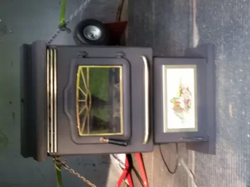

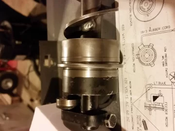

I recently bought a used Harman P61A pellet stove and am doing some cleaning and giving it the once over before installing it. I took the auger out to clean it and the chute. When I removed it, there was high temp rtv sealing it and part of an old O-ring appeared as I scraped it off. The O-ring was not complete so I'm guessing someone slathered on the rtv to seal it and called it good. I have looked everywhere for info on the auger and if it actually requires an O-ring, but nothing shows one or if it should even be sealed with rtv...In the picture there is a groove machined on both sides of the auger bearing that may hold an O-ring. Does anyone have any idea if an O-ring or rtv is required to seal it where the auger slides into the pipe?

No O-rings on the auger as far as I know, unless they've changed something. How old is the unit?
I can only guess that it is older than 2008...The old brochure I got with it had a dealer name on it so I emailed them for help on backtracking the serial number to find out the year...They said they cant do that, so I remain lost as to the age...it is in great shape though, so I believe it will last for years with proper cleaning and maintenance.
  • [Hearth.com] P61A auger question

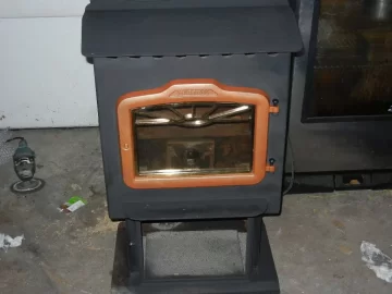

I have the same door on a PC45. I wouldn't worry about the age either. I found no o ring when I tore it down last winter or the other two I have been intimate with. Over use of silicone yes. Dealers should be able to find out the age for you. If you have it that far apart I would replace the door gaskets, preferably with graphite impregnated rope material. Swab of graphite grease on the door hinges will make them swing nice. Enjoy
