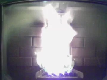

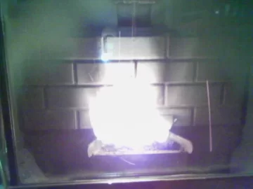

This is a quick post of the flame patterns you should expect to see..
first pic is full on high fire after pellets are feeding after say a door to outside was opened and the room temp dropped.
second is as the temp nears room temp setting.
third is low fire or maintenance burn (that is room temp is satisfied and stove is maintaining enough fire so as not to require the ignitor again)
actually the third is a little bit more than maintenance burn but it's close enough.
I've watched it cycle like this for hours tonite and it's about 25* outside right now.
The flame at all stages Is never lazy
Don't know about the quality of photos I used my phone for the pictures :red:

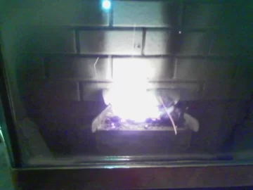

I took some pics - I'll try to attach them below.
This is the lazy flame, this doesn't always happen - no doors were opened or anything to cause this...
(broken link removed to http://i44.photobucket.com/albums/f30/FFNick40/100_4184.jpg)
This is what I normally see
(broken link removed to http://i44.photobucket.com/albums/f30/FFNick40/100_4186.jpg)
Is this considered a "dirty" stove? Should I clean all that off?
http://s44.photobucket.com/albums/f30/FFNick40/100_4185.jpg

As for your pictures, the fire seems normal, as does the stuff on the glass.
