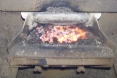

Utahdl, I have a P61. I leave the feed rate at about 3. I have used maybe three different types of pellets and I always get ash build up in the corner of the burn pot. No big deal, I just knock it off in the morning before I go to work. At night, when I fuel up the stove, I again knock of the ash build up. It is usually kinda fluffy stuff. I'll try to attach a pic that shows about 6 hours of build up (at mainly a med burn, your milage may vary).
Hope that this helps.

That picture looks like what I get.....If I see it I knock it into the ash pan. Sometimes I dont see it or the stove is running hard because it's cold and it will develop long fingers that get pushed into the ash pan.
Not a big deal IMHO and the stove still burns well with them there....(find it like that when I get home sometimes)
