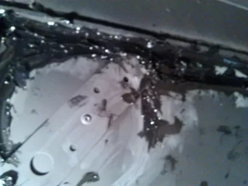

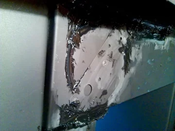

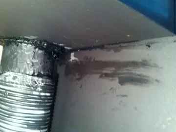

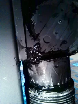

I agree that I shouldn't have had to do the sealing. At the very least, I should have been told this would be needed if when the outside air intake was used. Also a lot of the problem was due to the installation. The installers did not seal the pipe connections and the connection to the stove was crooked. The stove is still icy cold on cold days when there is no fire. So still think we need to add the cut off to block the air off when not needed. Uploaded the photos of the silicone sealant on the stove. Pretty messy. It was hard to get a bulky caulk gun between the stove and the wall. Much had to be done with applying the sealant with a popsicle stick. Many of the small spots are actually covering small holes. And this is all on the ash box. It did not get hot to the touch when the stove was burning. First 3 photos are from the back of the stove. The last photo is from the underside. There was a gap between the bottom of the stove and the leg. Am going to have to add some sealant to the front as well.
[Hearth.com] Pacific Energy  Neo 1.6 [Hearth.com] Pacific Energy  Neo 1.6 [Hearth.com] Pacific Energy  Neo 1.6 [Hearth.com] Pacific Energy  Neo 1.6
