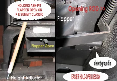

Yes, the lid can be held open by a coal, so make sure you push them away from where the lid seats, then close the lid. I tap mine a couple times with a poker to make sure it's seated. Then, as DuckDog mentioned, you can push some ash around the perimeter of the lid and run a shovel over it to pack it in. I'm not sure how much good this does, though.
