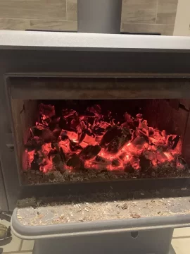

I have stove top thermometer on the Center of the stove half way through the burn I’m seeing temps around 400-500 degrees Fahrenheit

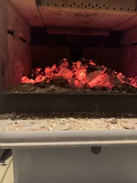

The first picture is after about 10 hrs of burning and the second is after having the air control wide open for 3 hrs to try and burn down the coals. The stove was shoveled out the day before.
Sooo? If you start from a empty, cleaned out stove.
You load a completely full to the brim load. Above the fire brick but not against the baffle.
You burn it for 10 hours without opening the loading door once.
You end up with a half a stove full of coals?
Or? Are you starting a clean stove with a partial load and continuously adding/feeding a split or two every few hours?
Just trying to figure out your routine.

This is exzactly what I am doing and all my wood is stored in my basement so it’s all heated

OK. Wood moisture should be ruled out because testing the outside of any of those splits in the basement is useless. Perplexing as moist fuel results in a similiar buildup!
Are you also saying that you operating the stove as I asked?
Ok. At the 10hr point your fuel is in the coaling stage, heavily, according to your pics. Guessing you are still getting plenty of heat output at the 10 hr point.
At 13hrs it has reduced substantially. Is the house temp staying in your comfort zone? Curious.
If it is I wouldn't sweat anything. Fill us in.
If your home temp doesn't drop off to far I would let it burn up those coals. I do it everyday. Stretching the load as far as possible and still fitting your daily schedule takes some strategizing.
Wish I had a better answer!
If the blower is on, then that is fine. If the blower is off then that is a little cool for halfway through the burn. Try opening up the air a little more, maybe 10% more or about 1/4" over on the air control.
Do you have any 2x4 cut offs? If so, toss one on the coals at 10 hrs and open up the air to 50%.
FWIW, as long as the house is heating well there are many that would be happy to see this. The coals at 10 hrs have plenty of heat left in them.

Stove top temp with coals like show is around 100-150 mark. I guess I’m pushing the stove to try and maintain a warmer temp in the house approx 20 degrees Celsius. I didnt buy the blower for my stove, wasent sure if it would make a difference or not where my stove is in my basement.
I still can't believe the manufacturers sell a stove without the blower if it's designed to run one. Major heat distribution gains in my experience. Install the/a blower and spool that thing up. I'll eat crow if it doesn't contribute nicely!
You have got to be talking Celsius.
Yes I’m talking Celsius haha
So 200-300ºF. That's important. 200F is low, 300F at 10-12 hrs is not bad. Try tossing in a couple 2x4 cutoffs on your next coal bed with 50% air at the 10hr point to get the stovetop up to 400+º F. Or if you have some good dry pine or fir splits that are about 3" thick that's fine too.
