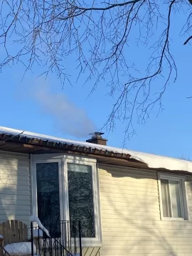

Hey everyone! Love this site! I’ve spent hours reading over the years and it’s time for my first post.
I just purchased a 2009 Alderlea t5. I’ve been burning wood for a long time and recently upgraded from a cheap E/W epa stove to the T5
When I’m getting the fire going on reloads I seem to get a lot of smoke out of the chimney for the first 1.5-2 hours. I am following the suggestions to cut primary air gradually and I am seeing secondary burn but probably not as much as I should. Primary is cut over 30 minimum.
Single wall pipe with magnetic thermometer will rise to 800 no problem. Stove top temps cruise at 650-700 and pipe temp will settle around 450. But I still have a solid plume of smoke out the chimney.
Wood is well seasoned. Mixed hardwood C/S for 2-3 years then moved into wood shed. Moisture meter reading 18-20% on fresh splits.
Burns seem to last quite well. I still have plenty of coals to restart after 12 hours on full loads.
It seems like I’m not getting as strong of secondary burn as I should. I’m willing to spend some money on the stove but wondering where I should start to improve secondary burn. Clean secondary supply tube? New insulation blankets? New door gasket?
Chimney is an interior brick chimney with clay liner. Draft is good and reliable. A cold chimney will suck a sheet of paper and hold it across the flue pipe when the stove is disconnected.

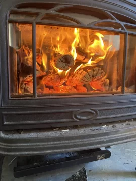

Currently it -15C outside here. Almost no wind. Loaded stove an hour ago. Stove top is almost 750F and single wall pipe is 550F about 24” about the stove.
I have some weak secondaries in the back of the stove but not much towards the front. This picture shows what my chimney looks like. Too grey to be steam IMO.

I would start with the secondary supply tube. You could rig up a narrow hose connected to a vacuum and stick it down there with the baffle removed. I considered doing this on mine but haven't got around to it yet.
This^^^ get a new gasket to replace the old one after you clean it out.
Your picture looked like a hot burn but not enough secondary flame.
