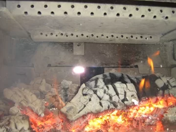

This is a picture of interior … can you say me if baffle regards ok?
  • [Hearth.com] Pacifk energy vista baffle
Welcome Annie. The baffle looks ok. It is missing the rear pin. Are you using a magnetic, surface, pipe thermometer or a probe thermometer? Do you know what your stove top temperature is?

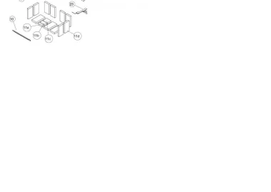

Can you give us some more photos? One of the boost manifold etc?

We place the boost manifold in the base of door inside see picture of parts

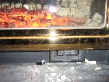

i have a other thermometer in das of door ( picture)

for the amount of coal in that stove right now i would open that air control full until the temp gets up to 650-700 and then close it down all the way to the bottem. Stopping in the middle where it is right now doesn't allow the temps to climb far enough for the secondairy to start working correctly.

Get a newer thermometer. That one you have below the door should be on top of the stove in the center, and looks ancient, not sure how accurate it may be.

Did they remove the baffle before sweeping? If not, there may be soot and ash laying on top of the baffle blocking or partially blocking the exhaust outlet.
If they pulled the baffle, did they cover the rear vertical air channel the baffle rests over? If that is not covered with a rag or something, it will also get clogged with ash/soot sweepings.

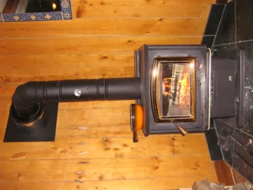

How tall is the piping outside & inside together? Has anyone checked the cap to make sure it is not clogged?
