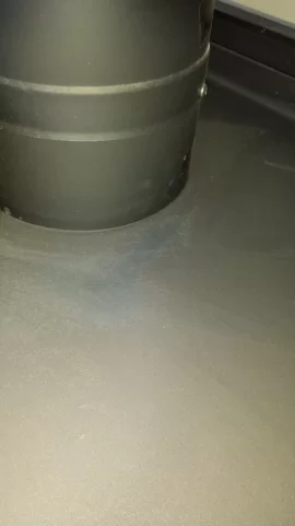

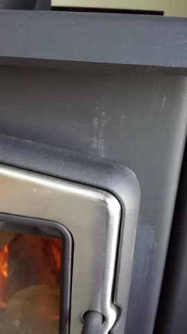

Good day all. I have a new Osburn 2400 installed shortly before Christmas. Been burning steady since mid Jan. Recently I've noticed that there is some paint peeling off. Anyone else seeing this?Link Removed Link Removed

Much better. Did you wipe dust or dirt off it while it was warm during the first few hot fires?
No I Never touch it while it's hot. The only time I dust the top is in the am before a relight. The top part I can understand as I had a steamer on it. Maybe it got to hot beneath it. On the side by the door I've never cleaned. Not sure why the paint is doing this
I think you miss diesels point. If you, or an installer brushed dirt off before the curing fires it could have broken, the bond on the paint.....
I would contact osburn just to be safe.
Yeah I Did the total install myself. Did the curing fire and all was good. Now about 2 months after of hard burning it's starting to do this. So you guys think I should contact Osburn or contact the deal that I bought it from?

Talked to the dealer I bought it from today. They are going to come out and lightly sand it then repaint it for me. It's that what u guys think is the right course of action?

I'll be interested to hear and see how the touch up went. In my experience it's pretty normal for a stove to need re-painting from time to time, so you'll have to re-paint your stove eventually to keep it looking new. I understand you're stove is just a few months old, so needing paint so soon is upsetting. However, the spots in your photos aren't very noticeable and I'll be interested to see if they can get a paint match that is less noticeable than what you have now. I know it seems like black paint is black paint, so how hard can it be to get a match, right? Maybe over time the new paint will fade and be closer to the rest of the stove, but I'll bet when the paint is new it's going to stand out more than the blemish. Good Luck.
It will stand out until the paint is baked. If the touchup paint is a match to the original after a few fires over 500F stovetop, the paint should blend in pretty well.
Glad to hear! I'll let you guys know how it turns out. Not sure when I'm getting it fixed up as I'm burning it every day all day.
A friend of mine has a Drolet Classic and the paint did the same thing. Something tells me they (SBI) had a bad batch of paint this year. They sent him a free can of paint and gave him some tips on how to repaint it. His stove was manufactured around the same time as yours.
