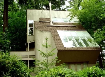

This stainless chimney was painted with latex house paint to match the house. The picture was taken 10 years later, right before we repainted the house. The chimney didn't need repainting

Dang! Looks good, Tom. Was there a coat of any sort of primer put on first? Rick
Rick, I don't know. We installed the chimney while the house was being built, and the contractor had it painted after we were gone. When our installers paint the portion of a stainless chimney that extends below the ceiling, they wipe it down with denatured alcohol first, let it dry thoroughly, then use Stove Bright spray paint. That technique lasts for years and years as well.
I imagine that above the roofline (or even anywhere above the ceiling adapter), the insulated chimney could probably be painted with darn near any decent paint, so long as the metal was nicely cleaned first. Seems to make sense to me...not like we're talking about the stove itself here, or single-wall pipe that sees high temps. (That's a pretty darned interesting looking house, BTW). Rick
