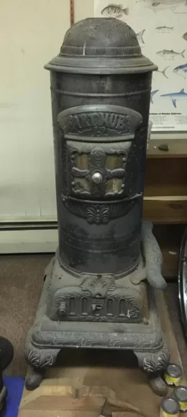

Any ideas? Thinking of a shed/bob house heater

Just be sure it is installed properly and safely. The stove will require 36" clearances in all directions and a proper hearth. Side and rear clearances can be reduced to as much as 12" with proper wall shielding.
You might enjoy this article on tall stoves.
I love these old stoves, but yours looks like a coal stove. You could burn wood in it, but I wouldn't leave it unattended.
Thanks, fellas - yes, this will be used much like a 55 gal drum, riddled with .30cal holes, outdoors. More of a conversation piece than a high efficiency heater.
