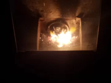

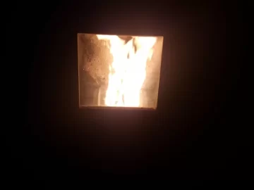

Has anyone opened up the slot in their restrictor plate to allow it to be closed more? I would like to feed less pellets since these gs's are really short. I already closed it as much as possible. Run on "d" mode, magic numbers on 1-5-1. I dont know how to lower the feed rate anymore.
When i used longer pellets the stove would idle down to 1-2" flames. This shipment is WAY shorter and my house temps keep climbing. Im afrade i will only b able to use my stove 3 to 4 weeks a year when the temps drop below 35deg. It has been an unusually warm winter. Would i run into problems by opening the slot and closing the hopper plate more? Thx, Bubba
Here is another thought. I do a lot of thinking sitting here roasting... i noticed my flame goes from 2" to 12" after the lower auger dumps. I timed my lower auger at 2rpm. I had thought that the lower auger rpm didnt matter but now i think that thought is flawed. With the lower auger pushing pellets out twice as fast it does not allow the top auger to meter the lower auger properly. Thus the liwer auger is not filling consistantly. Maybe filling every 3 flutes instead of every flute. Am i making sense??? Question is, if i put in a 1rpm lower motor, will i get jams?? I thought i read both were supposed to b 1rpm. What does everyone think? Attached are photos of pre dump and post dump.

They are both supposed to be 1 rpm. You are thinking correctly. The way it is now you will not get a constant flame. It will flare up and then burn down. Yes you could open the slot and close up the opening but you will find with a 1 rpm on the bottom it will be a more consistent burn
