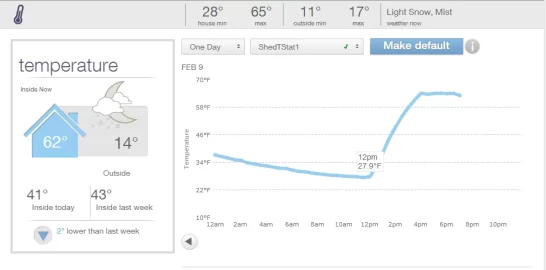

I just got the Iris Tstat I can regulate with my Iphone from Lowes and it graphs the temp for you! I use it for the Quadrafire stove in my shed!
I wanted to do some work in the shed this afternoon. At noon time it was 27.9 Deg F! Had to turnn the quadrafire on before I went out there! ! ! Brrrrrr!

The Quad goes into shutdown mode and stops feeding to save on pellets when the set temp is met. I set a 2 degree swing with a 70 Deg set point. So when the temp goes below 68 Degs F the stove starts back up. The specially designed loop igniter is very rugged and still lasts along time. :)

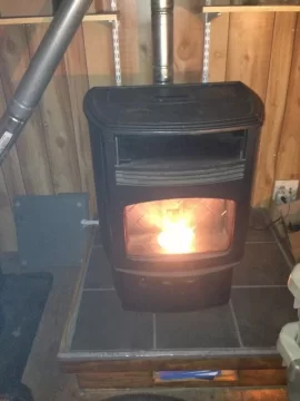

  • [Hearth.com] Pdvc why didn't i do it sooner?
