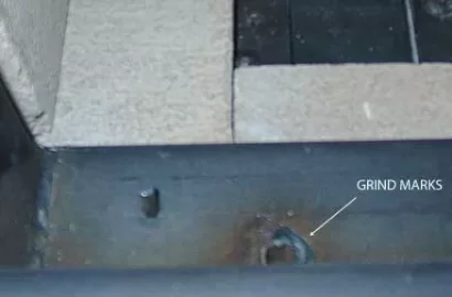

gasavage- Thanks for the pics...makes me feel a little better to know that something isnt
just missing from the stove. It just looks to be a sloppy weld job...not something you
should find in this grade of stove.

Can some kind owner of an Alderlea T5 that isn’t burning today, pull the boost manifold cover and post a picture of that whole area to this thread?
Here you go, BG. You can't see very well in this photo, but there was excess slag on this intake hole, which has been ground down at the factory. Looks like this step was omitted on the OP's stove. About 60 seconds with a grinding wheel in a power drill is all it will take to fix it.

thechimneysweep- Thanks for posting another pic for me. I am still waiting for the dealer
to call me back and tell me something. I could easily do the repair myself but I thought I
would make sure they didnt want to look it over first...dont want to void a warranty or
something. Still looks like sloppy work to me...compared to the T6 its damn rough. I
sure didnt expect to have to work on a brand new stove thou... If I do have to grind
the weld down...do I need to spray some stove paint on it to keep it from rusting?
