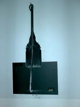

That plate doesn't get re-installed on the pedestal, the drawer goes in there .Here's what I did with the plate from ours:
  • [Hearth.com] PE Owners - Adding the ash dump system later?
