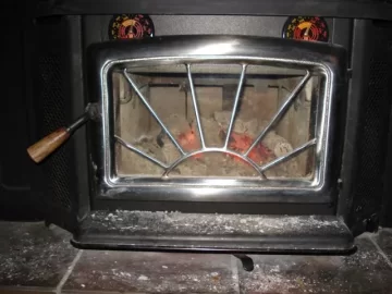

I had a bit of time to record the evening burn last night. The insert was running all day (wife and kids were home). When I first arrived home, the stove thermometers were reading at around 375F. I waited until it went to 350F and added three rounds and one split of Manitoba maple. It doesn't have a huge heat output and burns as fast or faster than poplar. I am just using it until the temps dip below 0C. Then I will break out the sugar maple, oak and ash.
After adding the wood, I opened the air control fully to get things going for about 15 minutes and then closed it fully.
After 1 hour - Reading 425F
30 minutes later - 550F
30 minutes later - Reading just over 650F
8 minutes later just under 700F
47 minutes later 600
25 minutes later 575F
44 minutes later 450F
I am sure that if I had filled the firebox and/or used sugar maple, the temps would have peaked higher. There also would have been a longer duration of hotter temperatures.
