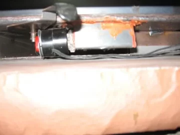

this season i installed a solenoid to the ebt.its controlled by an electronic controller.last year i had the controller control a car air bypass valve on my insert.it was a touch small.gonna see how this works this year.i dont think theres much of a gain but i like to tinker.

r500930 - now that is tinkering at its best :-)
interested to hear how it works out for you. I'm particularly interested if you discover anything consistent that enhances burn times.
