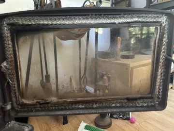

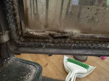

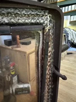

1) The door: the "door" is fine. It is the frame that holds the glass, that is the problem. See pics. I am worried I will not able to successfully remove (unscrew) the old clips and screw new ones tightly. I am also concerned about the "glass gasket" because this one seems to be of a special rope gasket type and size of material - again see pics. And also concerned I may receive incorrect parts for this Series A. Of course, if I dismantle this and mess it up (break off or strip the screws), or have incorrect parts, I will now have an unworkable stove until I can get the right parts or new door. And that could be many months given the difficulty in ordering and getting them. The "used" door option is worth pursuing. Can anyone confirm that any PE Summit door will fit this Summit Series A???

A complete door when the parts you need are available is pretty crazy. Ask the dealer to order those specific items. The door glass bar and clips should be under $200.
In short - I am not feeling a high degree of confidence I would even get a working air tight door. PE tells me I could run into trouble trying to rebuild my stove and have to re-tap the screw holes if they break off, etc. And I am still unclear if a "newer" replacement door would fit my stove.
This is possible, but not as bad as it sounds. The old stub drills out quickly with a fresh bit and the tapping is easy. It's about a 10-minute job with the right tools. Would the place that offered to build up a door do this with the current door instead of a new one? If not, a local machine shop could drill and tap if a bolt breaks.

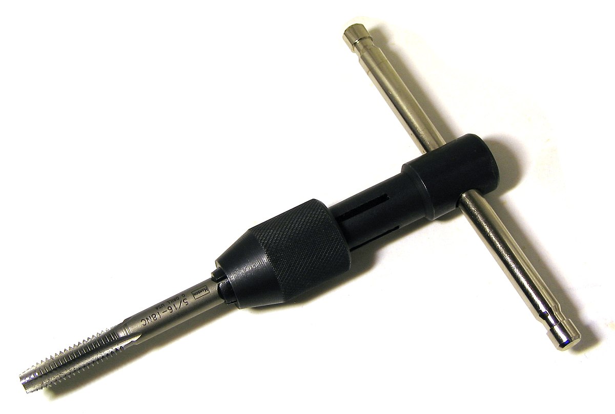

I never did a drill and tap before I rebuilt our Jotul 602. It turned out to be quite easy. I soaked the bolts in penetrating oil overnight. Most came out, but 2 broke. I made sure that I had the right-sized drill bit, and got a cheap bottoming tap of the right size from the local hardware store, then proceeded slowly. Like I said, the actual process took about 10 minutes per bolt.

Good to know. Not sure what a bottoming tap is, and I imagine I need to use a drill press - which I would have to buy. My cheapo broke a while ago. :) But it is a useful thing to know how to do, and you can teach an old dog new tricks.

No need for a drill press. Just remove the door and lay it flat, keep the drill perpendicular. I used a slightly smaller drill bit first to remove the shank of the bolt, then went with the tap-sized drill bit. Google bottoming tap, the tip does not taper. This is for blind holes as there will be on the door frame.
