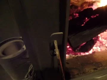

No, you don't tap on the door, you tap on the latch that is bolted to the stove to tighten the gap, which in turn sucks the door in tighter, but if it's not loose don't bother. Have you tried the dollar bill test to see if your gasket is sealing tightly?

All you need is a straight screwdriver & a hammer. Rest the screwdriver against the latch catch, and tap it with a hammer, Go a little at a time, maybe 1/16", till the door is snug enough that you cannot easily pull a dollar out of the seal when closed & latched. It does NOT need to be super tight, or hard to pull out, just snug. As long as the dollar can't be wiggled side to side, you're good. See photo of catch to tap on.

Different strokes. I've done it countless times now on customers stoves with my rubber mallet. Easy peasy, no damage or marks.
