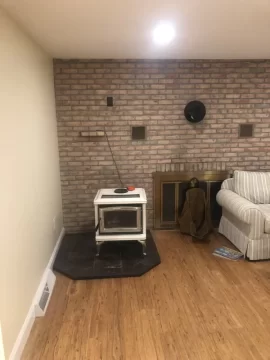

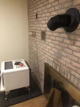

1. Any concerns if I put the stove very close to this brick wall? I understand a little room for airflow could be beneficial with efficiency, but my main concern is making sure there are no fire hazards.

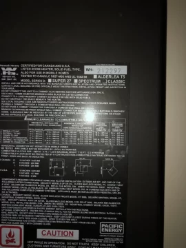

2. I’m attaching pics of the data plate and how my stove is sitting right now. Other than the fact that I should have some floor protection under the single wall pipe as it angles from the stove to the flue, see any issues with my proposed install?

Why not put the stove right under the flue pipe in front of the fireplace?
Yes you can put it closer to the brick than the listed cleanrace to combustibles as long as your positive it’s solid brick. My summit is 4” off my non combustible wall and it gets warm to the touch but not hot.

My house is quite small and I have to maximize all of my space. So, I’m trying it offset like this for two reasons. One, down the road I want to build a raised hearth and use the empty fireplace cavern for wood storage. And two, I need as much space on the other side of the fireplace for a custom cabinet setup to house my record collection. I need to keep the hat as far away from the stove as possible.
I’m hoping it will heat fairly well tucked in the corner the way it is.
