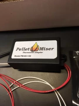

If you're talking about the Pelpro pp130 with the dial control, you don't have many options for adding a thermostat. The only thing I found that worked is the Pellet Miser thermostat adapter. They used to be sold on EBay, but I haven't seen them in a while.
  • [Hearth.com] Pel Pro pp130 Thermostat
