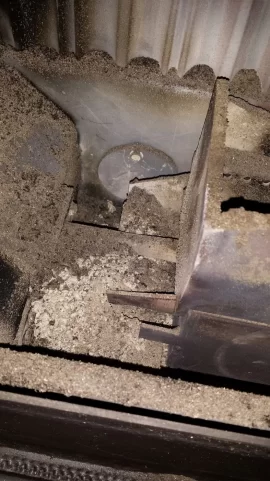

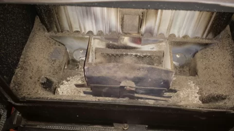

And my ash still builds up on the sides. It is very fluffy but it just piles up on the sides. See pictures attached (this is after about 5 days, before i cleaned it). I'll start reading some other forums for ideas to make sure i'm getting maximum efficiency. Next step is to do a full clean since i'm almost through 2 tons. [Hearth.com] pellet backup into chute[Hearth.com] pellet backup into chute
