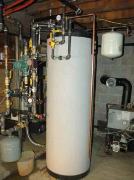

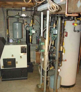

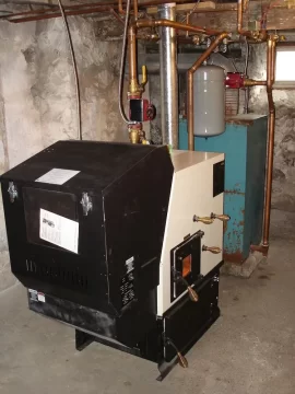

    I'll include a few pics to show what I have done with the pellet boiler. In behind the Harman is a Liberty 30 that I bought off Craigslist for $350 and was only 7 years old. I use the Liberty for a backup to the PB. Both boilers feed into a Smart 100 Triangle Tube indirect water heater and are in parallel to one another. Both boilers can operate either singly or together and only heat the tank. A stainless Grundfos pumps the hot water through a 50 plate HX and a Taco 0012 pumps out to the radiant floor and to the upstairs. The two boilers can supply about 235,000 Btus to the tank if run together. The Smart is also the DHW supply.
