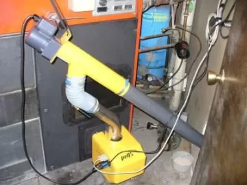

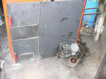

Well I don’t know if I am the first but I have converted my boiler to a pellet boiler with a PellX conversion unit. The unit includes a pellet burner, like an oil burner but with a larger hole (6â€) into the boiler. The unit and control panel operates on 110v 60hz electricity. The panel allows me to program the shut off temperature, a choice of 4 starts up temperatures, the amount of startup pellets, the amount of operating pellets, the air speed and max burn time. A 1.7m auger was included. This is a self start and shut off unit. I built a pellet storage bunker out of plywood that stores 1 ton of pellets ready to use. This heats my 5 zone (1700 sq ft) ranch house and domestic hot water just like the old oil unit. I had a machine shop provide me with two 1/16†steel plates, one foot square with four mounting holes in the same location so I could switch out the burners at any time. I have used just short of 8 tons of pellets this year since September and we are still cold outside, today 38 F High for the day. I will be burning all year as this does my hot water as well.
I need to clean the burner every 1000# (takes about 15 minutes) and the boiler every 2000# (takes about 1 hour including the burner. Once I adjusted the burner I have not had a problem with the unit. I would have used about 1500 gal of fuel oil for the year at say $3.00 per Gal or $4,500. for the year. I have paid $250. per ton of pellets or $2,000. I paid $3250 for the PELLX unit and installed the unit myself. So my first year cost will be $4,500-2,000= $2,500 Then $2,500-3250=$750 to be paid off on the PELLX burner. This is a no brainer for those with the proper boiler and a bit of knowledge.
What are your thoughts?

What boiler did you convert? Is the domestic coil in boiler or do you use an indirect? How about some pics .
Will

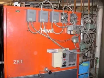

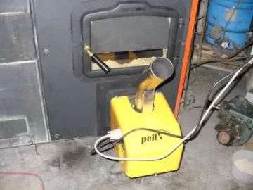

Last Fall I converted my Hoval ZKT to a pellet burner using a PellX 20KW burner conversion. The original Hoval was a 30 year old multi fuel boiler made by Gustav Ospelt Hovalwerk AG In Liechtenstein. When I bought it new I was told that I could heat with anything-Oil, Nat Gas, Liquid Propane, Wood, Electric or Coal. I don't think that Wood Pellets were even a gleam in the eye of the manufacture. I think it has a 150 gal of heating hot water and 50 gal of domestic hot water. Several of the years I used a mix of Coal in the late fall, after temperatures were below 35F, winter and early spring switching to Oil for the rest of the year as I used this for my hot water all year. I would usually go through 4 tons of coal (say $980) and 450 gal of oil (say $1,500).
The Hoval that I have was a perfect unit for conversion. What I have found out is that I need to clean the burner every 1000# of pellets burned and clean the boiler every ton of pellets burned. This requires that you can gain access to the fire box and heat exchanger. My Hoval has a swing open door that opens up the front of the unit for cleaning. I then use a small shovel to clean the ash off the bottom of the boiler and a brush and vacuum to clean the heat exchanger (after it has cooled off). I spend about 10 to 15 minutes to clean the burner and half an hour to clean the boiler.
The PellX unit comes complete with the control box that allows you to adjust several functions to get the proper burn. I can adjust the amount of pellets feed rate for start up, pellets feed rate to operate, fan speed and the temperature on the high limit as well as 4 start up temperature options based on the high temperature shut off. An auger is included that is about 1.7 meters feet long. The unit also includes a temperature sending unit that needs a well in the boiler for shut off temperature. I did need to buy a safety temperature shut off as a safety back up. (this has never been triggered) The burner has a high temperature shut off on the pellet inlet stack. (this has shut the unit down three times when I have not cleaned the burner often enough.) The PellX unit is self lighting, self shut off, self feeding and somewhat self cleaning of the burner.

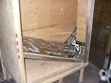

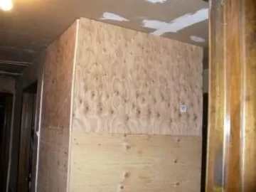

As I said this is a conversion unit so I do not have the attached bin like many units that holds what 100# of pellets? My bin 1 ton at a time. I built mine out of plywood on legs with tin for the bottom to help the pellets slide down to a 3†pvc toilet fitting that goes into a 3†pvc “Yâ€. I used a 45 degree “Y†unit that drops the pellets into the straight part of the “Yâ€. This allows me to remove and replace the auger if needed while the bin is loaded. (it comes out easy but need some fooling with to get back in)
My plans are to make my own pellets starting this spring. I have found a supply of product and plan to process and produce about 600# every hour. But that is another story. Let me know if you are interested. I have included photo’s of the above. Let me know what you think.

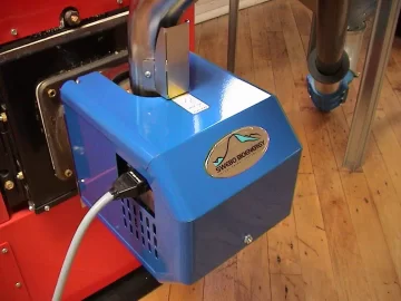

Swebo burners haven't been mentioned in this thread. They are also Swedish technology, and run on high and low limits. A back-up oil boiler would have high and low limits below the high and low limits of the pellet boiler. This keeps the pellet boiler running as much as possible. Power levels can also be adjusted so that in spring and fall, the burner can run at lower power and so with longer run times which increases the efficiency. Adjustments can also be made to all four phases of combustion, and to fan speeds at every power level. As with all the Swedish burners, they are very well made.

Thank you for your input. You sound very knowledgeable about the Swebo Boiler, you must be a dealer or sales person. I tried to find a Swebo pellet burner replacement but I did not notice one on any of the web sites. You made several excellent notations about boilers but in general it seems that you did not even read my input.

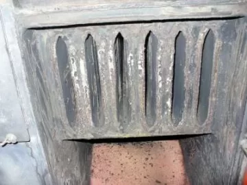

The issues that you are pointing out like a door for cleaning—as you will notice from my pictures my front of the boiler 3’ X 2’ opens all the way up to expose the heat exchanger as well as the ash pit. My boiler has a 16†x 22†pit 4†below the burner for ash. I am able to burn 1 ton of pellets with only 3“of ash or 4 gallons before I need to clean it.
My heat exchanger has chambers that I can get a 2 foot brush from the front to the back as well as enough width to get my vacuum cleaning attachment that is also 2 feet long from the front to the back. The pellets that I burn have burned off the deposits from years of oil burning and all I have now is some ash powder that falls off with a brush or the vacuum.
My combustion chamber is 16†X 22†X 15†this provides me enough space to burn the original 225,000 BTU with oil so I guess that it can take 22kw of heat. (what that 66,000 BTU)
As I mentioned I have a two sets of plates that attach my burners to the boiler that use 4 bolts. With this set up I can change back to oil in 10 Minutes. I live in upstate NY and we have just had a very cold and snowy winter in which my 22KW unit never fell behind.
You seem familiar with the Swebo units. I mentioned that my cost was $3250 but you failed to mention the cost of the Swebo (even without instillation). I looked for specks on the Swebo but I could not find any. Does it run on 110V 60 Hz or is it the 220/240V European unit? When hooked up with an oil burner do you need a separate chimney or do you put it through the same one? My PELLX unit has a separate controller that hangs on the wall to minimizes the vibrations to protect the electronics, where is your controller? I have a compressed air line from my controller to the burner that is the self cleaning portion of the burner, is yours self cleaning and how does it work? How about some information on your unit?

You've got good access to the combustion chamber, and a good spot for collecting the ash. Not many are as fortunate when looking to retrofit an oil boiler.
This is a good size combustion chamber. Because the boiler is designed for much higher (4x) the pellet burner output, I would worry about there being not enough flue gasses to make turbulent flow through the tubes. That can reduce the heat transfer. But what really counts is how it's working for you, and it seems that it's working fine. Making adjustments to lower power levels in the spring and fall may not work so well, but you can try. Perhaps with more aggressive turbulators.
That's very good. The ideal for most people would be to have the oil boiler set up in parallel, so that if you aren't able to feed pellets to the bin for any reason before it empties out, the oil boiler takes over automatically.

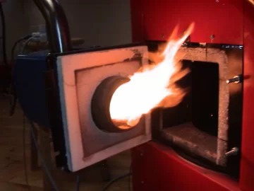

The cost for Swebo burners is similar to what you quote. The burners run on 120V/60Hz. You do need a separate chimney if there is the possibility of running both at once. The controller is included with the burner, but is mounted separately, like yours. Swebo burners must be cleaned manually. That's very simple and quick to do. Although we can sell burners separately, we also have a whole package of equipment that go together: EcoBoiler, Swebo burner, controller, auger and storage. Feel free to contact me for an exact quote, or for other specifications, sample schematics, payback info, etc.

I do like the photo that shows that our burners are alike in that they blow over and through the flame chamber and are not a suction unit like most of the pellet stoves.
Is that the only door to clean your unit? It what 10" X 10"? Do you have a unit in you house as well or just the photo's from Swebo?
The photos you see are ours. The door you see in the photos is on our EcoBoiler here in East Walpole, Massachusetts. This is our own American-made ASME certified boiler, not a Swebo product. The dimensions on the door are 12" x 12". There's another door below to access the ash bin, and another door above for cleaning the flue tubes.
